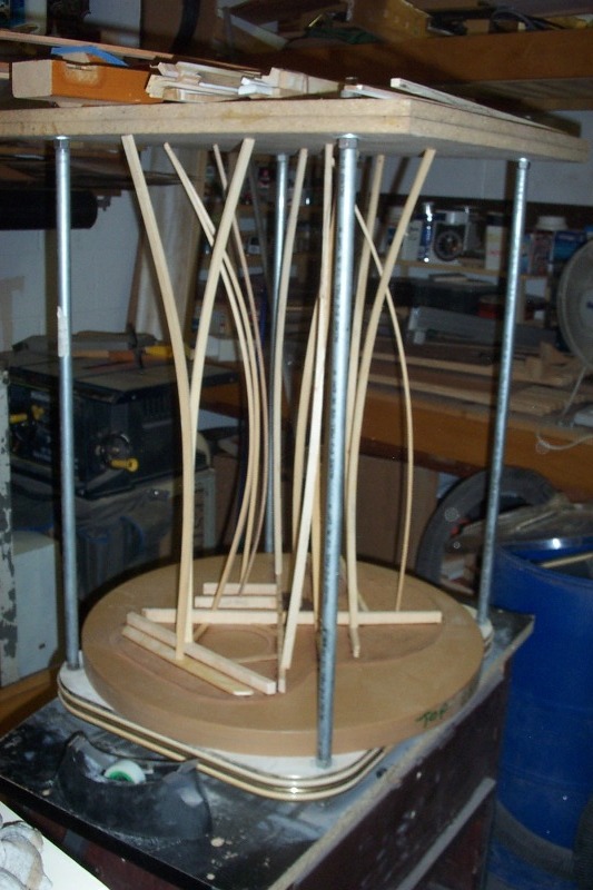

So to glue on the top, one way is to use a go-bar deck and a radiused dish in the bottom of the deck that corresponds to the radius you put on your braces. The braces are pressed down on the top, which is pressed down into the dish. Good luck!

Mike, here's a pic of a 25' radius dish in the go bar deck, the guitar top is in there with the braces that have been sanded in the same dish with a big round sheet of 80 grits sandpaper and their bottoms now at the same radius of the dish are being glued on the underside of the top with flexed bars , hope this helps! Serge
